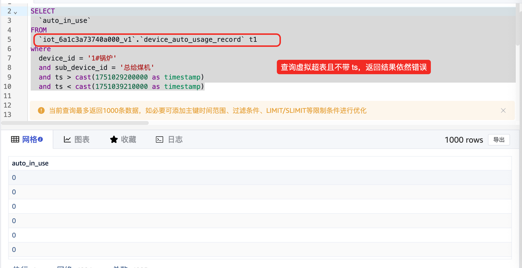

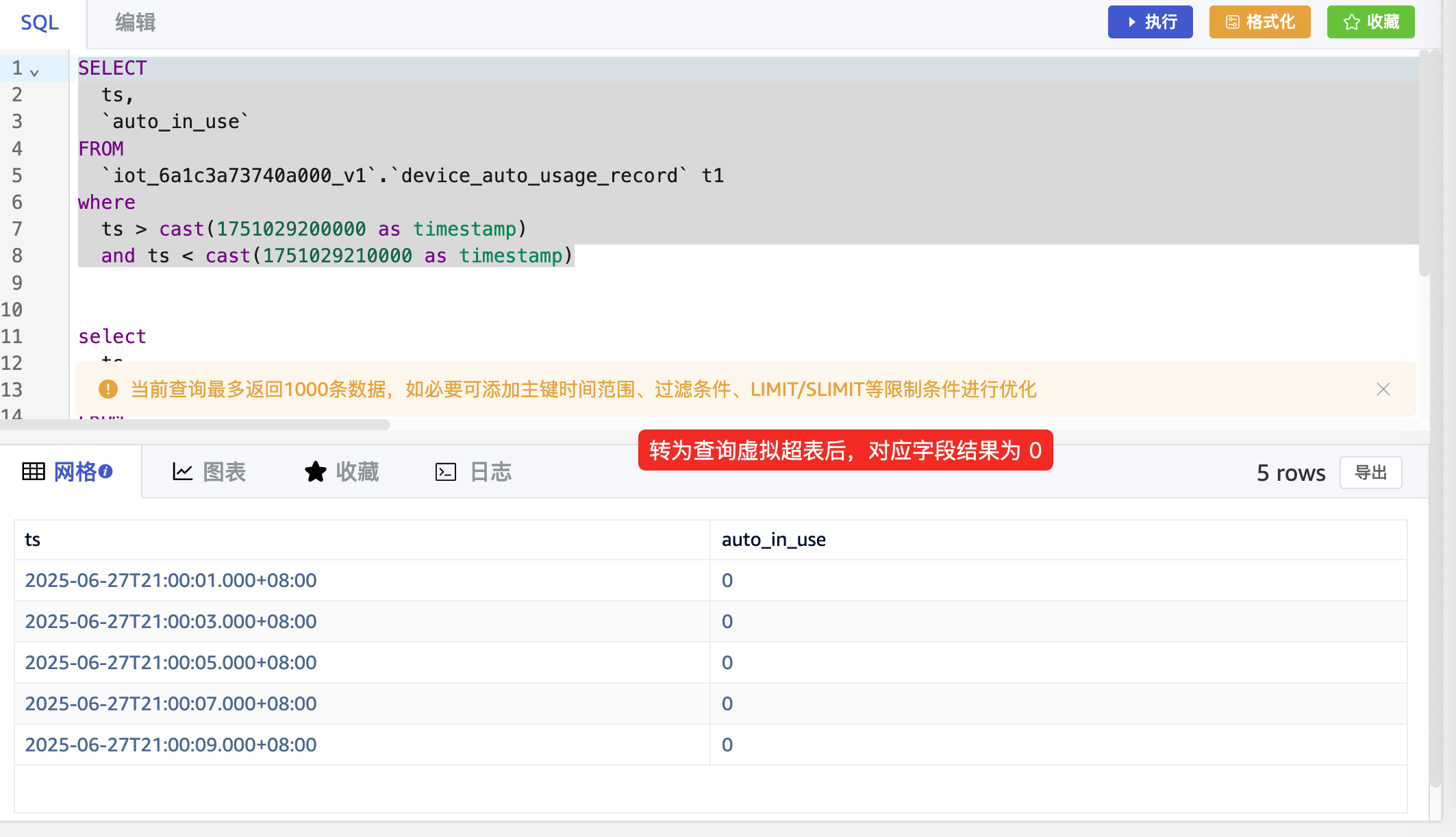

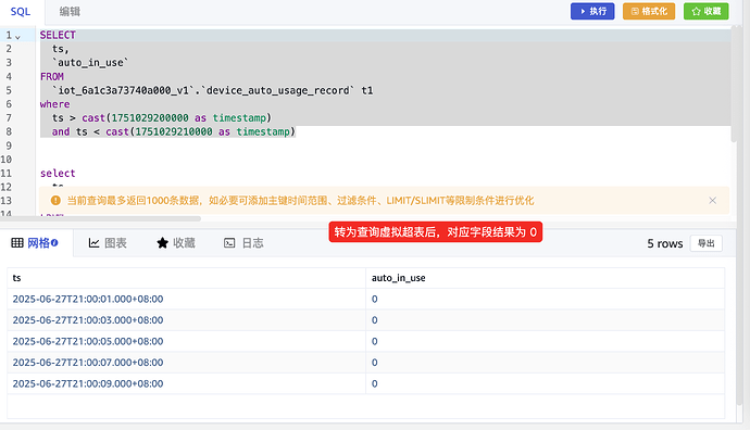

查询虚拟超表对应的字段结果与原始关联表的字段结果不一致
TSDB-OSS 3.3.7.0
严重
1、超表定义
CREATE STABLE iot_6a1c3a73740a000_v1.device_auto_usage_record ( ts TIMESTAMP ENCODE ‘delta-i’ COMPRESS ‘lz4’ LEVEL ‘medium’, total_in_use FLOAT ENCODE ‘delta-d’ COMPRESS ‘lz4’ LEVEL ‘medium’, auto_in_use FLOAT ENCODE ‘delta-d’ COMPRESS ‘lz4’ LEVEL ‘medium’ ) TAGS (device_id VARCHAR(64), sub_device_id VARCHAR(64)) SMA(ts, total_in_use, auto_in_use) VIRTUAL 1
2、虚拟表定义
CREATE VTABLE iot_6a1c3a73740a000_v1.device_auto_usage_record_sf25 (total_in_use FROM iot_6a1c3a73740a000_v1.boiler_auto_standard_8f3aa032-1bea-442b-9d2b-a3f07a91be84.boilerEnable, auto_in_use FROM iot_6a1c3a73740a000_v1.boiler_auto_standard_8f3aa032-1bea-442b-9d2b-a3f07a91be84.coalFeederAutoStatus ) USING iot_6a1c3a73740a000_v1.device_auto_usage_record (device_id, sub_device_id) TAGS (“1#锅炉”, “总给煤机”)

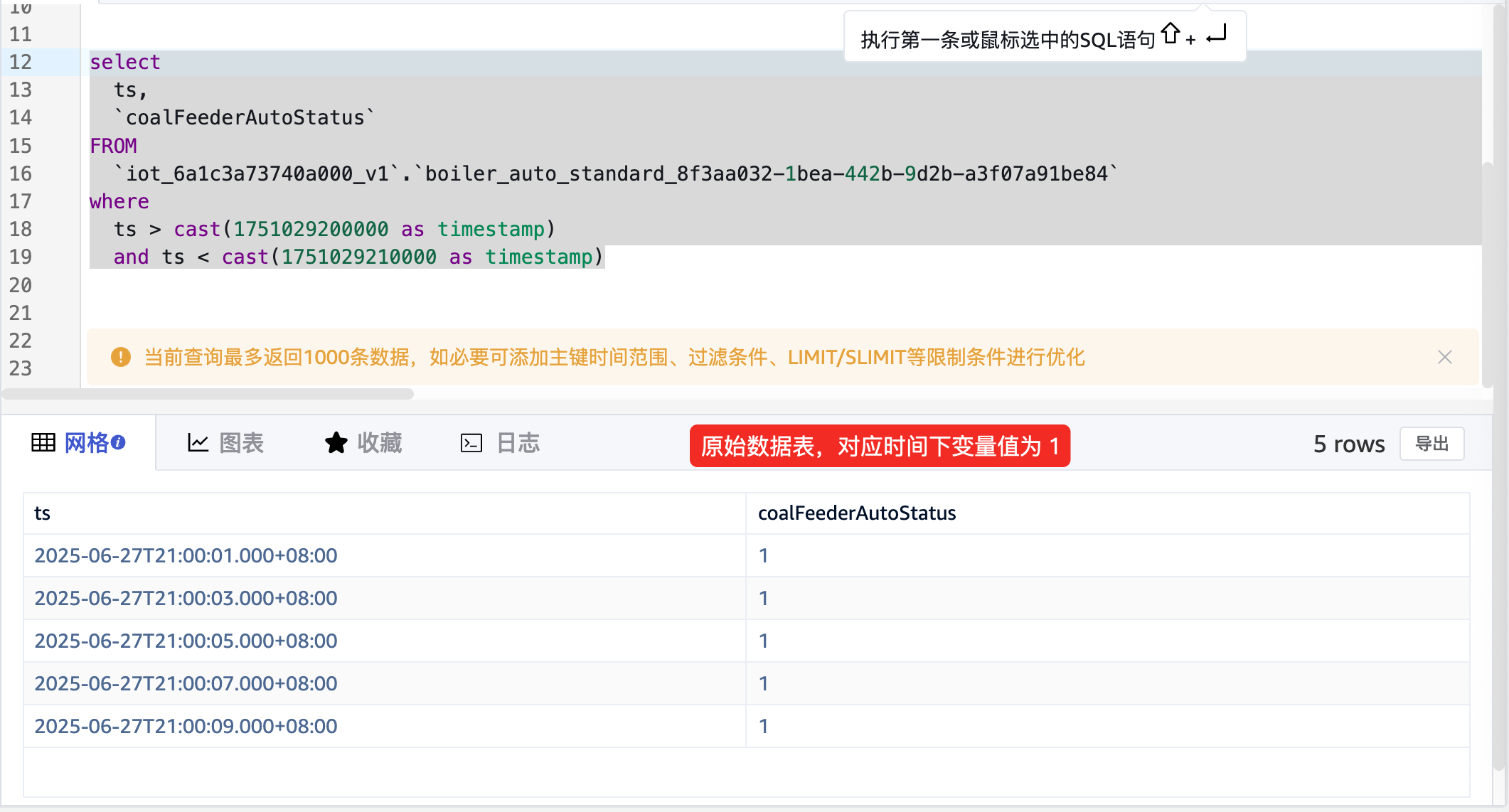

CREATE STABLE boiler_auto_standard (ts TIMESTAMP ENCODE ‘delta-i’ COMPRESS ‘lz4’ LEVEL ‘medium’, __placeholder__ TINYINT ENCODE ‘simple8b’ COMPRESS ‘lz4’ LEVEL ‘medium’, coalFeedertotalAIField FLOAT ENCODE ‘delta-d’ COMPRESS ‘lz4’ LEVEL ‘medium’, minBedTemperatureField FLOAT ENCODE ‘delta-d’ COMPRESS ‘lz4’ LEVEL ‘medium’, attemperatorWater2AO FLOAT ENCODE ‘delta-d’ COMPRESS ‘lz4’ LEVEL ‘medium’, secondaryAirQualityFlowField FLOAT ENCODE ‘delta-d’ COMPRESS ‘lz4’ LEVEL ‘medium’, boilerOnline FLOAT ENCODE ‘delta-d’ COMPRESS ‘lz4’ LEVEL ‘medium’, noxField FLOAT ENCODE ‘delta-d’ COMPRESS ‘lz4’ LEVEL ‘medium’, attemperatorWaterEnable FLOAT ENCODE ‘delta-d’ COMPRESS ‘lz4’ LEVEL ‘medium’, primaryAirVolSmooth FLOAT ENCODE ‘delta-d’ COMPRESS ‘lz4’ LEVEL ‘medium’, primaryAirVol FLOAT ENCODE ‘delta-d’ COMPRESS ‘lz4’ LEVEL ‘medium’, bedPressureDiffField FLOAT ENCODE ‘delta-d’ COMPRESS ‘lz4’ LEVEL ‘medium’, primaryAirFanAutoStatus FLOAT ENCODE ‘delta-d’ COMPRESS ‘lz4’ LEVEL ‘medium’, attemperatorWater2AutoStatus FLOAT ENCODE ‘delta-d’ COMPRESS ‘lz4’ LEVEL ‘medium’, steamFlowSmooth FLOAT ENCODE ‘delta-d’ COMPRESS ‘lz4’ LEVEL ‘medium’, coalFeederAutoStatus FLOAT ENCODE ‘delta-d’ COMPRESS ‘lz4’ LEVEL ‘medium’, attemperatorWater1AdjustStatus FLOAT ENCODE ‘delta-d’ COMPRESS ‘lz4’ LEVEL ‘medium’, secondaryAirVol FLOAT ENCODE ‘delta-d’ COMPRESS ‘lz4’ LEVEL ‘medium’, attemperatorWater2AdjustStatus FLOAT ENCODE ‘delta-d’ COMPRESS ‘lz4’ LEVEL ‘medium’, so2Field FLOAT ENCODE ‘delta-d’ COMPRESS ‘lz4’ LEVEL ‘medium’, attemperatorWater2AI FLOAT ENCODE ‘delta-d’ COMPRESS ‘lz4’ LEVEL ‘medium’, boilerAutoStatus FLOAT ENCODE ‘delta-d’ COMPRESS ‘lz4’ LEVEL ‘medium’, primaryAirqualityFlowField FLOAT ENCODE ‘delta-d’ COMPRESS ‘lz4’ LEVEL ‘medium’, rightBedTemperatureField FLOAT ENCODE ‘delta-d’ COMPRESS ‘lz4’ LEVEL ‘medium’, attemperatorWater2Enable FLOAT ENCODE ‘delta-d’ COMPRESS ‘lz4’ LEVEL ‘medium’, attemperatorWaterAutoStatus FLOAT ENCODE ‘delta-d’ COMPRESS ‘lz4’ LEVEL ‘medium’, totalCoalField FLOAT ENCODE ‘delta-d’ COMPRESS ‘lz4’ LEVEL ‘medium’, secondaryAirFanAutoStatus FLOAT ENCODE ‘delta-d’ COMPRESS ‘lz4’ LEVEL ‘medium’, slagCoolerEnable FLOAT ENCODE ‘delta-d’ COMPRESS ‘lz4’ LEVEL ‘medium’, steamPressureField FLOAT ENCODE ‘delta-d’ COMPRESS ‘lz4’ LEVEL ‘medium’, boilerEnable FLOAT ENCODE ‘delta-d’ COMPRESS ‘lz4’ LEVEL ‘medium’, coalQualityField3 FLOAT ENCODE ‘delta-d’ COMPRESS ‘lz4’ LEVEL ‘medium’, secondaryAirOutPress FLOAT ENCODE ‘delta-d’ COMPRESS ‘lz4’ LEVEL ‘medium’, coalQualityField2 FLOAT ENCODE ‘delta-d’ COMPRESS ‘lz4’ LEVEL ‘medium’, slagCoolerEnable1 FLOAT ENCODE ‘delta-d’ COMPRESS ‘lz4’ LEVEL ‘medium’, slagCoolerEnable2 FLOAT ENCODE ‘delta-d’ COMPRESS ‘lz4’ LEVEL ‘medium’, coalFeederAOField1 FLOAT ENCODE ‘delta-d’ COMPRESS ‘lz4’ LEVEL ‘medium’, slagCoolerEnable3 FLOAT ENCODE ‘delta-d’ COMPRESS ‘lz4’ LEVEL ‘medium’, coalFeederAOField2 FLOAT ENCODE ‘delta-d’ COMPRESS ‘lz4’ LEVEL ‘medium’, steamTemperatureSmooth FLOAT ENCODE ‘delta-d’ COMPRESS ‘lz4’ LEVEL ‘medium’, coalFeederAOField3 FLOAT ENCODE ‘delta-d’ COMPRESS ‘lz4’ LEVEL ‘medium’, oxygenExhaustLeftSmooth FLOAT ENCODE ‘delta-d’ COMPRESS ‘lz4’ LEVEL ‘medium’, oxygenExhaust FLOAT ENCODE ‘delta-d’ COMPRESS ‘lz4’ LEVEL ‘medium’, oxygenExhaustLeft FLOAT ENCODE ‘delta-d’ COMPRESS ‘lz4’ LEVEL ‘medium’, funnelTemperatureField FLOAT ENCODE ‘delta-d’ COMPRESS ‘lz4’ LEVEL ‘medium’, secondaryAirCurrent FLOAT ENCODE ‘delta-d’ COMPRESS ‘lz4’ LEVEL ‘medium’, secondaryAirAI FLOAT ENCODE ‘delta-d’ COMPRESS ‘lz4’ LEVEL ‘medium’, draftFanAO FLOAT ENCODE ‘delta-d’ COMPRESS ‘lz4’ LEVEL ‘medium’, slagCoolerOutWater2 FLOAT ENCODE ‘delta-d’ COMPRESS ‘lz4’ LEVEL ‘medium’, airChamber_PresA FLOAT ENCODE ‘delta-d’ COMPRESS ‘lz4’ LEVEL ‘medium’, slagCoolerOutWater1 FLOAT ENCODE ‘delta-d’ COMPRESS ‘lz4’ LEVEL ‘medium’, attemperatorWater1InTemp FLOAT ENCODE ‘delta-d’ COMPRESS ‘lz4’ LEVEL ‘medium’, airChamber_PresB FLOAT ENCODE ‘delta-d’ COMPRESS ‘lz4’ LEVEL ‘medium’, boilerAdjustStatus FLOAT ENCODE ‘delta-d’ COMPRESS ‘lz4’ LEVEL ‘medium’, steamFlowField FLOAT ENCODE ‘delta-d’ COMPRESS ‘lz4’ LEVEL ‘medium’, negPressureField FLOAT ENCODE ‘delta-d’ COMPRESS ‘lz4’ LEVEL ‘medium’, coalFeederAIField3 FLOAT ENCODE ‘delta-d’ COMPRESS ‘lz4’ LEVEL ‘medium’, coalFeederAIField2 FLOAT ENCODE ‘delta-d’ COMPRESS ‘lz4’ LEVEL ‘medium’, coalFeederAIField1 FLOAT ENCODE ‘delta-d’ COMPRESS ‘lz4’ LEVEL ‘medium’, test_flag FLOAT ENCODE ‘delta-d’ COMPRESS ‘lz4’ LEVEL ‘medium’, slagCoolerAutoStatus2 FLOAT ENCODE ‘delta-d’ COMPRESS ‘lz4’ LEVEL ‘medium’, slagCoolerAutoStatus FLOAT ENCODE ‘delta-d’ COMPRESS ‘lz4’ LEVEL ‘medium’, coalPerAOField1 FLOAT ENCODE ‘delta-d’ COMPRESS ‘lz4’ LEVEL ‘medium’, slagCoolerAutoStatus3 FLOAT ENCODE ‘delta-d’ COMPRESS ‘lz4’ LEVEL ‘medium’, coalPerAOField3 FLOAT ENCODE ‘delta-d’ COMPRESS ‘lz4’ LEVEL ‘medium’, slagCoolerAI1 FLOAT ENCODE ‘delta-d’ COMPRESS ‘lz4’ LEVEL ‘medium’, slagCoolerAutoStatus1 FLOAT ENCODE ‘delta-d’ COMPRESS ‘lz4’ LEVEL ‘medium’, coalPerAOField2 FLOAT ENCODE ‘delta-d’ COMPRESS ‘lz4’ LEVEL ‘medium’, slagCoolerAI2 FLOAT ENCODE ‘delta-d’ COMPRESS ‘lz4’ LEVEL ‘medium’, coalFeederAdjustStatus3 FLOAT ENCODE ‘delta-d’ COMPRESS ‘lz4’ LEVEL ‘medium’, slagCoolerAI3 FLOAT ENCODE ‘delta-d’ COMPRESS ‘lz4’ LEVEL ‘medium’, coalFeederEnable3 FLOAT ENCODE ‘delta-d’ COMPRESS ‘lz4’ LEVEL ‘medium’, coalFeederEnable FLOAT ENCODE ‘delta-d’ COMPRESS ‘lz4’ LEVEL ‘medium’, coalFeederEnable2 FLOAT ENCODE ‘delta-d’ COMPRESS ‘lz4’ LEVEL ‘medium’, draftFanAI FLOAT ENCODE ‘delta-d’ COMPRESS ‘lz4’ LEVEL ‘medium’, boilerBlowing FLOAT ENCODE ‘delta-d’ COMPRESS ‘lz4’ LEVEL ‘medium’, coalFeederEnable1 FLOAT ENCODE ‘delta-d’ COMPRESS ‘lz4’ LEVEL ‘medium’, oxygenExhaustRight FLOAT ENCODE ‘delta-d’ COMPRESS ‘lz4’ LEVEL ‘medium’, attemperatorWater2InTemp FLOAT ENCODE ‘delta-d’ COMPRESS ‘lz4’ LEVEL ‘medium’, draftFanAdjustStatus FLOAT ENCODE ‘delta-d’ COMPRESS ‘lz4’ LEVEL ‘medium’, draftFanEnable FLOAT ENCODE ‘delta-d’ COMPRESS ‘lz4’ LEVEL ‘medium’, secondaryAirAO FLOAT ENCODE ‘delta-d’ COMPRESS ‘lz4’ LEVEL ‘medium’, furnacePressureDiffField FLOAT ENCODE ‘delta-d’ COMPRESS ‘lz4’ LEVEL ‘medium’, windChamberPressureSmooth FLOAT ENCODE ‘delta-d’ COMPRESS ‘lz4’ LEVEL ‘medium’, oxygenExhaustRightSmooth FLOAT ENCODE ‘delta-d’ COMPRESS ‘lz4’ LEVEL ‘medium’, coalFeederAdjustStatus2 FLOAT ENCODE ‘delta-d’ COMPRESS ‘lz4’ LEVEL ‘medium’, attemperatorWater1Enable FLOAT ENCODE ‘delta-d’ COMPRESS ‘lz4’ LEVEL ‘medium’, primaryAirFanAdjustStatus FLOAT ENCODE ‘delta-d’ COMPRESS ‘lz4’ LEVEL ‘medium’, coalFeederAdjustStatus1 FLOAT ENCODE ‘delta-d’ COMPRESS ‘lz4’ LEVEL ‘medium’, waterTemperatureField FLOAT ENCODE ‘delta-d’ COMPRESS ‘lz4’ LEVEL ‘medium’, negPressureSmooth FLOAT ENCODE ‘delta-d’ COMPRESS ‘lz4’ LEVEL ‘medium’, coalFeedertotalAOField FLOAT ENCODE ‘delta-d’ COMPRESS ‘lz4’ LEVEL ‘medium’, draftAirInPress FLOAT ENCODE ‘delta-d’ COMPRESS ‘lz4’ LEVEL ‘medium’, furnacePressureDiffB FLOAT ENCODE ‘delta-d’ COMPRESS ‘lz4’ LEVEL ‘medium’, coalFeederBlockStatus3 FLOAT ENCODE ‘delta-d’ COMPRESS ‘lz4’ LEVEL ‘medium’, coalFeederBlockStatus FLOAT ENCODE ‘delta-d’ COMPRESS ‘lz4’ LEVEL ‘medium’, coalFeederBlockStatus1 FLOAT ENCODE ‘delta-d’ COMPRESS ‘lz4’ LEVEL ‘medium’, coalFeederBlockStatus2 FLOAT ENCODE ‘delta-d’ COMPRESS ‘lz4’ LEVEL ‘medium’, secondaryAirFanAdjustStatus FLOAT ENCODE ‘delta-d’ COMPRESS ‘lz4’ LEVEL ‘medium’, leftBedTemperatureField FLOAT ENCODE ‘delta-d’ COMPRESS ‘lz4’ LEVEL ‘medium’, primaryAirOutPress FLOAT ENCODE ‘delta-d’ COMPRESS ‘lz4’ LEVEL ‘medium’, primaryAirCurrent FLOAT ENCODE ‘delta-d’ COMPRESS ‘lz4’ LEVEL ‘medium’, slagCoolerAO3 FLOAT ENCODE ‘delta-d’ COMPRESS ‘lz4’ LEVEL ‘medium’, slagCoolerOutWataer3 FLOAT ENCODE ‘delta-d’ COMPRESS ‘lz4’ LEVEL ‘medium’, windChamberPressureField FLOAT ENCODE ‘delta-d’ COMPRESS ‘lz4’ LEVEL ‘medium’, totalQualityFlowField FLOAT ENCODE ‘delta-d’ COMPRESS ‘lz4’ LEVEL ‘medium’, waterPressureField FLOAT ENCODE ‘delta-d’ COMPRESS ‘lz4’ LEVEL ‘medium’, furnacePressureDiffA FLOAT ENCODE ‘delta-d’ COMPRESS ‘lz4’ LEVEL ‘medium’, coalQualityField1 FLOAT ENCODE ‘delta-d’ COMPRESS ‘lz4’ LEVEL ‘medium’, oxygenExhaustSmooth FLOAT ENCODE ‘delta-d’ COMPRESS ‘lz4’ LEVEL ‘medium’, avgBedTemperatureField FLOAT ENCODE ‘delta-d’ COMPRESS ‘lz4’ LEVEL ‘medium’, slagCoolerAO1 FLOAT ENCODE ‘delta-d’ COMPRESS ‘lz4’ LEVEL ‘medium’, slagCoolerAO2 FLOAT ENCODE ‘delta-d’ COMPRESS ‘lz4’ LEVEL ‘medium’, attemperatorWater1AO FLOAT ENCODE ‘delta-d’ COMPRESS ‘lz4’ LEVEL ‘medium’, attemperatorWater1OutTemp FLOAT ENCODE ‘delta-d’ COMPRESS ‘lz4’ LEVEL ‘medium’, primaryAirFanEnable FLOAT ENCODE ‘delta-d’ COMPRESS ‘lz4’ LEVEL ‘medium’, waterFlowField FLOAT ENCODE ‘delta-d’ COMPRESS ‘lz4’ LEVEL ‘medium’, attemperatorWater2OutTemp FLOAT ENCODE ‘delta-d’ COMPRESS ‘lz4’ LEVEL ‘medium’, topTemperatureField FLOAT ENCODE ‘delta-d’ COMPRESS ‘lz4’ LEVEL ‘medium’, draftFanCurrent FLOAT ENCODE ‘delta-d’ COMPRESS ‘lz4’ LEVEL ‘medium’, attemperatorWater1AI FLOAT ENCODE ‘delta-d’ COMPRESS ‘lz4’ LEVEL ‘medium’, attemperatorWater1AutoStatus FLOAT ENCODE ‘delta-d’ COMPRESS ‘lz4’ LEVEL ‘medium’, slagCoolerAdjustStatus1 FLOAT ENCODE ‘delta-d’ COMPRESS ‘lz4’ LEVEL ‘medium’, maxBedTemperatureField FLOAT ENCODE ‘delta-d’ COMPRESS ‘lz4’ LEVEL ‘medium’, slagCoolerAdjustStatus3 FLOAT ENCODE ‘delta-d’ COMPRESS ‘lz4’ LEVEL ‘medium’, furnacePressureDiffSmooth FLOAT ENCODE ‘delta-d’ COMPRESS ‘lz4’ LEVEL ‘medium’, slagCoolerAdjustStatus2 FLOAT ENCODE ‘delta-d’ COMPRESS ‘lz4’ LEVEL ‘medium’, draftFanAutoStatus FLOAT ENCODE ‘delta-d’ COMPRESS ‘lz4’ LEVEL ‘medium’, coalFeederAutoStatus3 FLOAT ENCODE ‘delta-d’ COMPRESS ‘lz4’ LEVEL ‘medium’, attemperatorWater2OutTempSmooth FLOAT ENCODE ‘delta-d’ COMPRESS ‘lz4’ LEVEL ‘medium’, layerPressB FLOAT ENCODE ‘delta-d’ COMPRESS ‘lz4’ LEVEL ‘medium’, secondaryAirFanEnable FLOAT ENCODE ‘delta-d’ COMPRESS ‘lz4’ LEVEL ‘medium’, steamTemperatureField FLOAT ENCODE ‘delta-d’ COMPRESS ‘lz4’ LEVEL ‘medium’, layerPressA FLOAT ENCODE ‘delta-d’ COMPRESS ‘lz4’ LEVEL ‘medium’, coalFeederAutoStatus2 FLOAT ENCODE ‘delta-d’ COMPRESS ‘lz4’ LEVEL ‘medium’, coalFeederAutoStatus1 FLOAT ENCODE ‘delta-d’ COMPRESS ‘lz4’ LEVEL ‘medium’, primaryAirAI FLOAT ENCODE ‘delta-d’ COMPRESS ‘lz4’ LEVEL ‘medium’, primaryAirAO FLOAT ENCODE ‘delta-d’ COMPRESS ‘lz4’ LEVEL ‘medium’, coalQualityFieldCorr3 FLOAT ENCODE ‘delta-d’ COMPRESS ‘lz4’ LEVEL ‘medium’, coalQualityFieldCorr2 FLOAT ENCODE ‘delta-d’ COMPRESS ‘lz4’ LEVEL ‘medium’, coalQualityFieldCorr1 FLOAT ENCODE ‘delta-d’ COMPRESS ‘lz4’ LEVEL ‘medium’) TAGS (corpId VARCHAR(32), uid VARCHAR(64)) SMA(ts,__placeholder__)
CREATE TABLE boiler_auto_standard_8f3aa032-1bea-442b-9d2b-a3f07a91be84 USING boiler_auto_standard (corpId, uid) TAGS (“6a1c3a73740a000”, “8f3aa032-1bea-442b-9d2b-a3f07a91be84”)

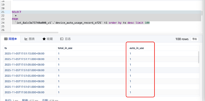

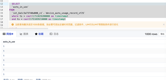

你试一下不加 ts 条件的结果是否正确,

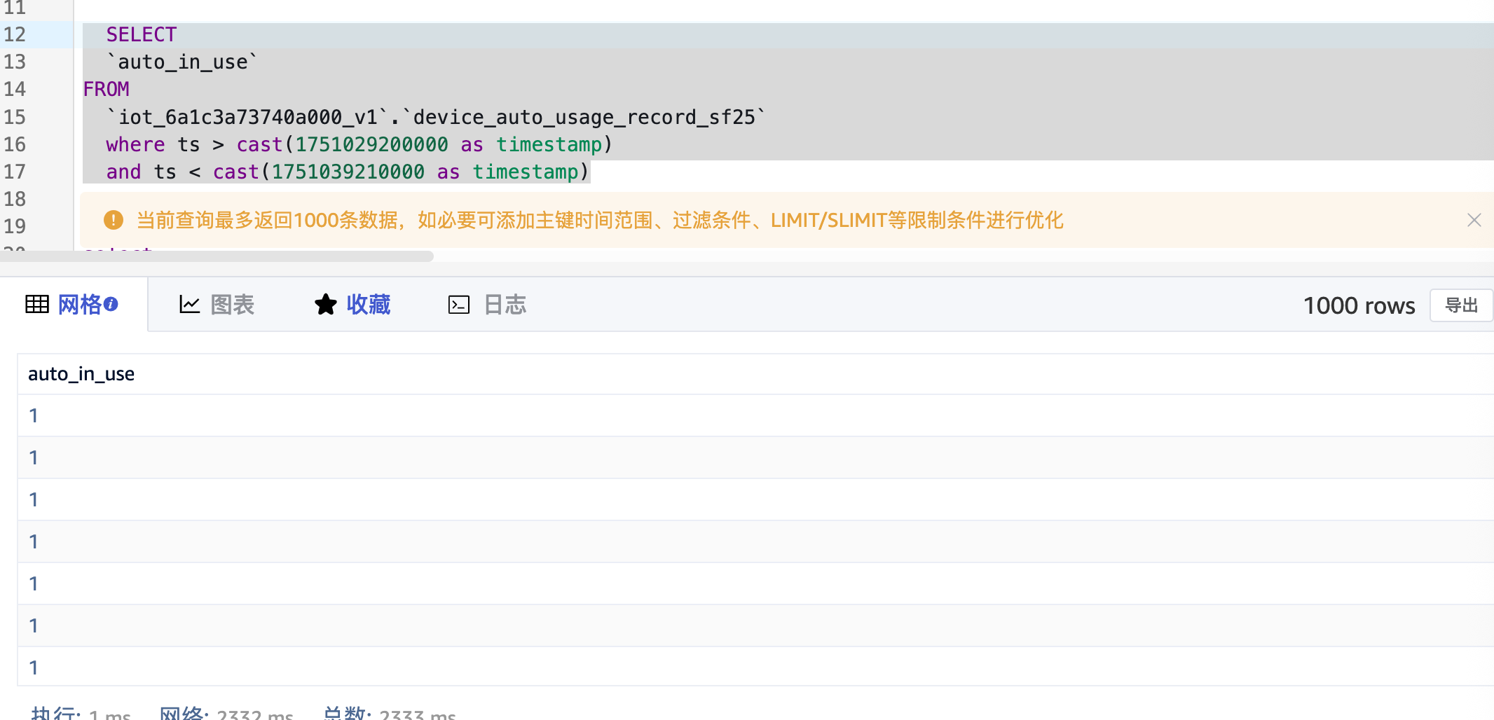

再试一下单独查虚拟子表的结果是否正确
1、查询虚拟超表且不带 ts,结果错误
2、查询虚拟子表,结果返回正确

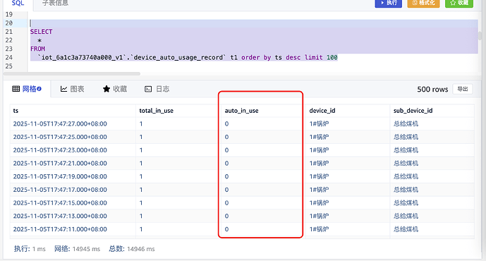

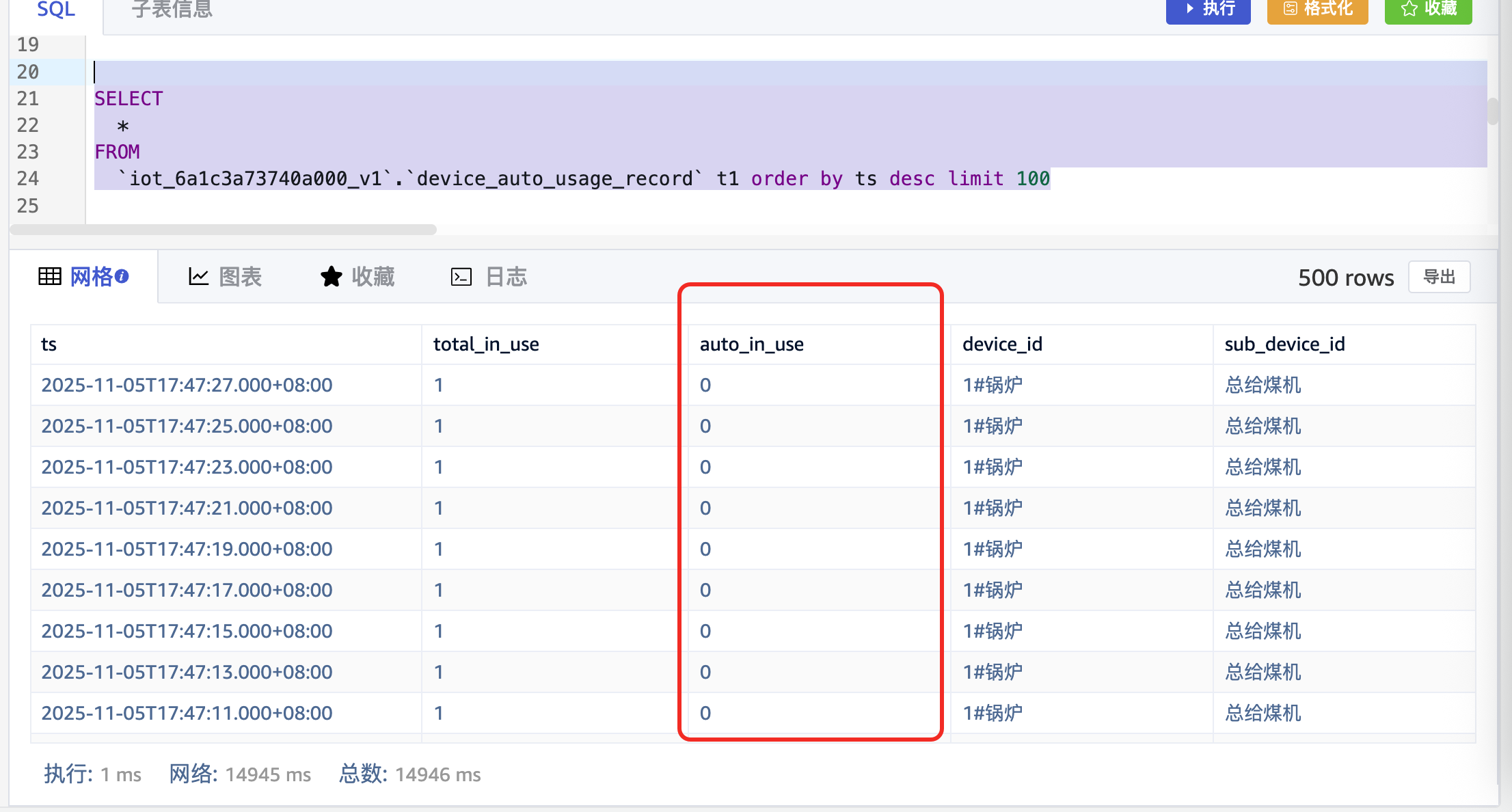

你直接 select * from device_auto_usage_record 看一下结果是啥
  1. 直接查询结果还是错误
2、直接查询子表结果正确
