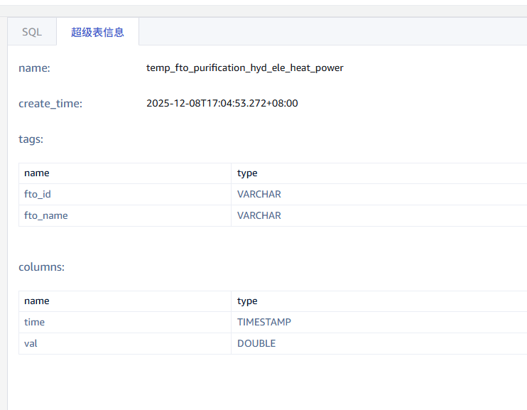

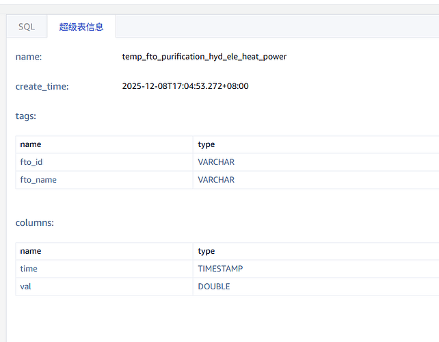

好的大佬,漏了一张计算过程中得表

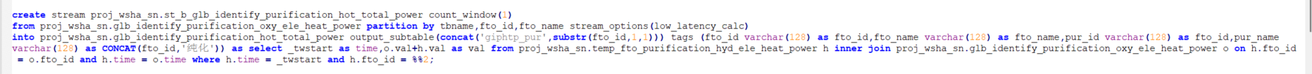

这个是创建流得语句
create stream proj_wsha_sn.st_b_glb_identify_purification_hot_total_power count_window(1)
from proj_wsha_sn.glb_identify_purification_oxy_ele_heat_power partition by tbname,fto_id,fto_name stream_options(low_latency_calc)
into proj_wsha_sn.glb_identify_purification_hot_total_power output_subtable(concat(‘giphtp_pur’,substr(fto_id,1,1))) tags (fto_id varchar(128) as fto_id,fto_name varchar(128) as fto_name,pur_id varchar(128) as fto_id,pur_name varchar(128) as CONCAT(fto_id,‘纯化’)) as select _twstart as time,o.val+h.val as val from proj_wsha_sn.temp_fto_purification_hyd_ele_heat_power h inner join proj_wsha_sn.glb_identify_purification_oxy_ele_heat_power o on h.fto_id = o.fto_id and h.time = o.time where h.time = _twstart and h.fto_id = %%2;

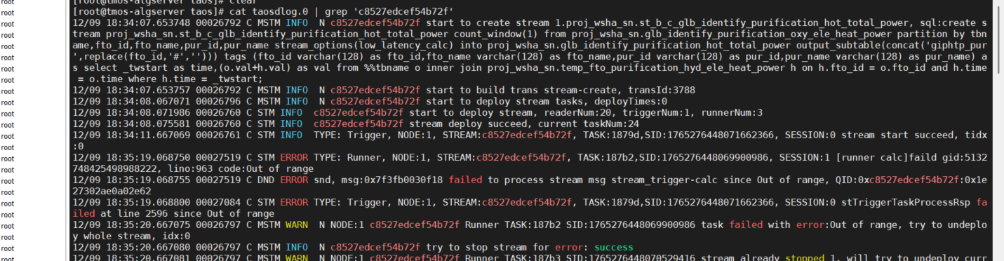

我改成这样不崩溃了,但是触发得时候报错了,大佬能帮忙看看么?这个日志没输出全,没看明白
