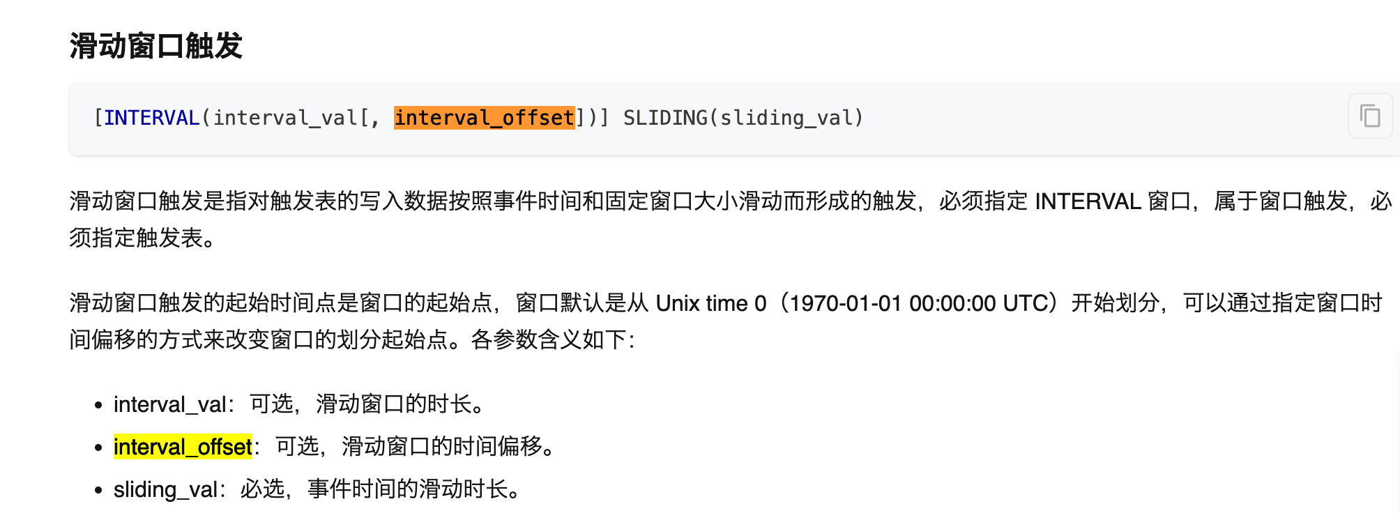

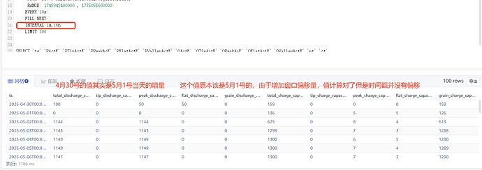

【求助】以下是完整sql 我在使用 INTERVAL(1d) n y 发现给出的数据是东八8点开始的 我期望是按照东八零点 我哪里不对 如何调整 或者说是taos原本就是这样设定的
SELECT
_WSTART AS ts,
Max(`PActE`)-MIN(`PActE`) AS total_discharge_capacity,
Max(`PTipActE`)-MIN(`PTipActE`)AS tip_discharge_capacity,
Max(`PPeakAcE`)-MIN(`PPeakAcE`)AS peak_discharge_capacity,
Max(`PFlatActE`)-MIN(`PFlatActE`)AS flat_discharge_capacity,
Max(`PValleyActE`)-MIN(`PValleyActE`)AS grain_discharge_capacity,
Max(`OActE`)-MIN(`OActE`)AS total_charge_capacity,
Max(`OTipActE`)-MIN(`OTipActE`)AS tip_charge_capacity,
Max(`OPeakAcE`)-MIN(`OPeakAcE`)AS peak_charge_capacity,
Max(`OFlatActE`)-MIN(`OFlatActE`)AS flat_charge_capacity,
Max(`OValleyActE`)-MIN(`OValleyActE`)AS grain_charge_capacity
FROM (
SELECT _irowts AS tm ,
INTERP(`PActE`)AS`PActE` ,INTERP(`PTipActE`)AS`PTipActE`,INTERP(`PPeakAcE`)AS`PPeakAcE`,INTERP(`PFlatActE`)AS`PFlatActE`,INTERP(`PValleyActE`)AS`PValleyActE`,
INTERP(`OActE`)AS`OActE`,INTERP(`OTipActE`)AS`OTipActE`,INTERP(`OPeakAcE`)AS`OPeakAcE`,INTERP(`OFlatActE`)AS`OFlatActE`,INTERP(`OValleyActE`)AS`OValleyActE`
FROM `sav`.`eee20250103`
RANGE(1745942400000 , 1751299200000)
EVERY(10m)
FILL(NEXT))
INTERVAL(1d)
LIMIT 100
