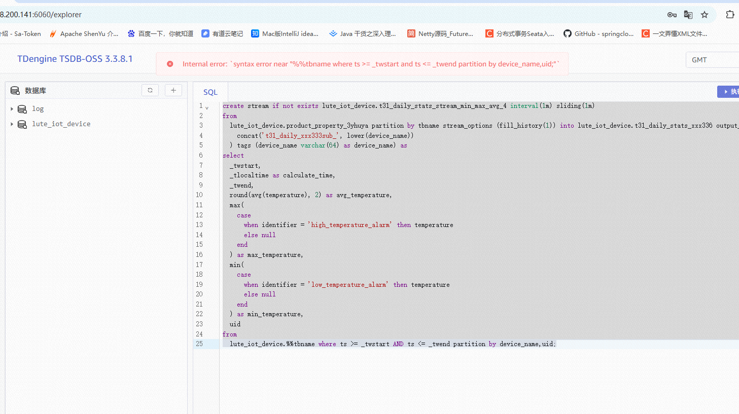

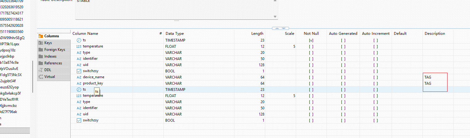

以上是我的表结构,流计算语法如下:
create stream if not exists lute_iot_device.t31_daily_stats_stream_min_max_avg_3 interval(1m) sliding (1m) from lute_iot_device.product_property_3yhuya partition by device_name stream_options (fill_history (1)) into lute_iot_device.t31_daily_stats_xxx333 output_subtable ( concat(‘t31_daily_xxx333sub_’, lower(device_name)) ) tags (device_name varchar(64) as device_name) as select _twstart as ts, _tlocaltime as calculate_time, _twend as window_end, round(avg(temperature), 2) as avg_temperature, max( case when identifier = ‘high_temperature_alarm’ then temperature else null end ) as max_temperature, min( case when identifier = ‘low_temperature_alarm’ then temperature else null end ) as min_temperature, uid from lute_iot_device.product_property_3yhuya partition by device_name, uid; 1分钟统计1次提示查询错误

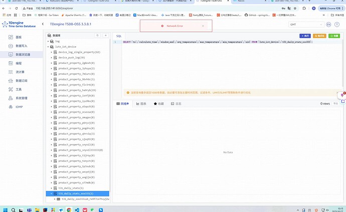

无法查询流计算出来的表
执行一个简单的sql会报错吗?

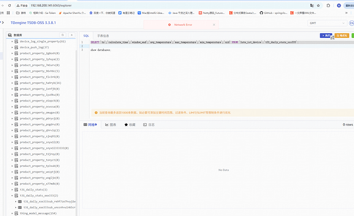

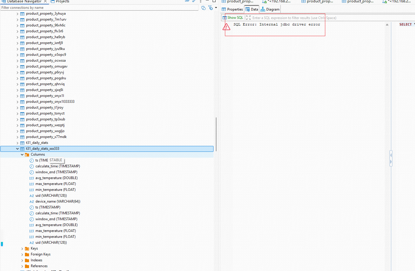

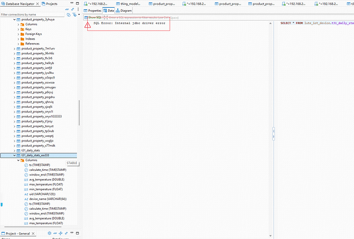

是滴 select * from lute_iot_device.t31_daily_stats_xxx333; 我这样简单查询一下就报错了
dbeaver 中 执行sql show databases 会报错吗
show databases; 不会报错

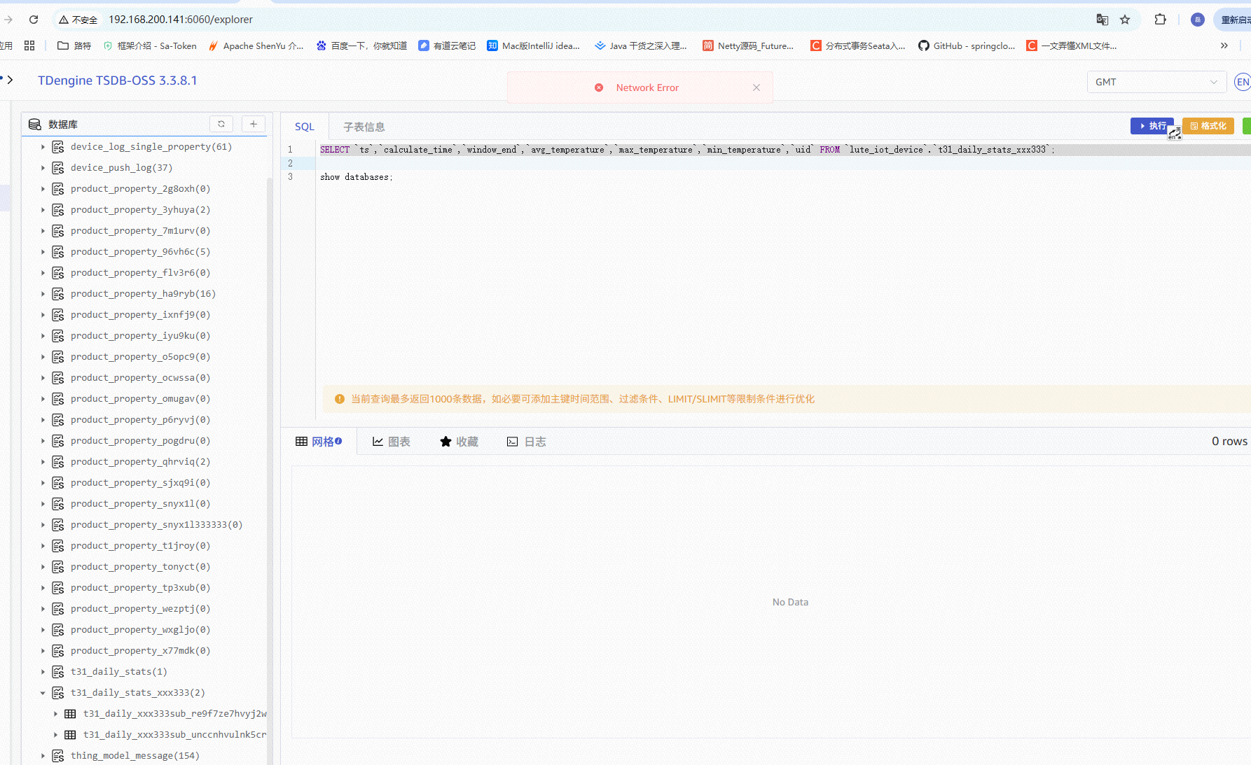

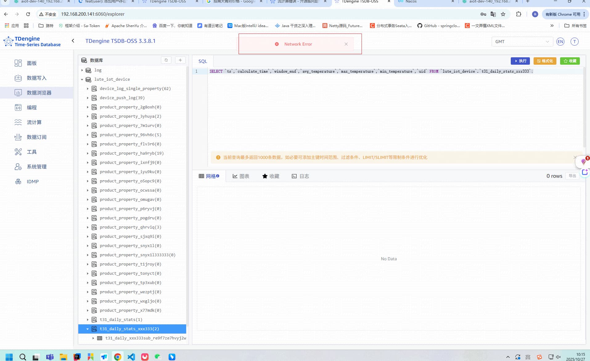

在dbeaver中会提示
在自带的客户端会提示network error
查询那个超级表会报错但是show databases
是没问题的

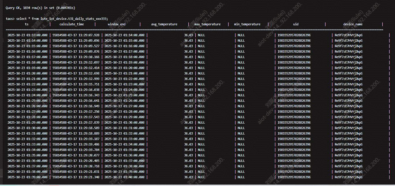

能使用taos shell,执行select * from lute_iot_device.t31_daily_stats_xxx333;这个sql吗?缩小一下范围,看看是哪个环节在报错
用taos shell没报错 但是
图形化查询报错,然后我换这个流语法create stream if not exists lute_iot_device.t31_daily_stats_stream_min_max_avg interval(1d) sliding(1d) from lute_iot_device.product_property_3yhuya partition by device_name stream_options(watermark(2m) | fill_history(1)) into lute_iot_device.t31_daily_stats output_subtable(concat(‘t31_daily_sub_’, lower(device_name))) tags (device_name varchar(64) as device_name) as select _twstart as ts, now() as calculate_time, _twend as window_end, round(avg(temperature), 2) as avg_temperature, max(case when identifier = ‘high_temperature_alarm’ then temperature else null end) as max_temperature, min(case when identifier = ‘low_temperature_alarm’ then temperature else null end) as min_temperature, uid from lute_iot_device.product_property_3yhuya partition by device_name, uid; 换成了now函数 他不统计上一天的数据了。

写法可能和3.3.6.13出入很大 我换了一个写法直接报错,我的一个设备可能被多个人使用我想统计每个设备每个人的信息,上面的写法会提示错误
%%tbname 前面不需要写db名称,因为%%tbname已经可以明确指明查询的库表信息了
