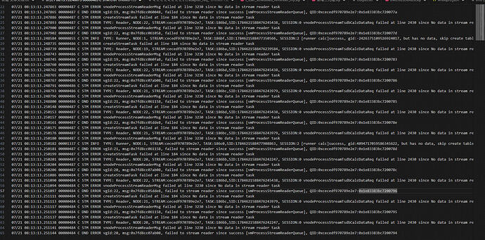

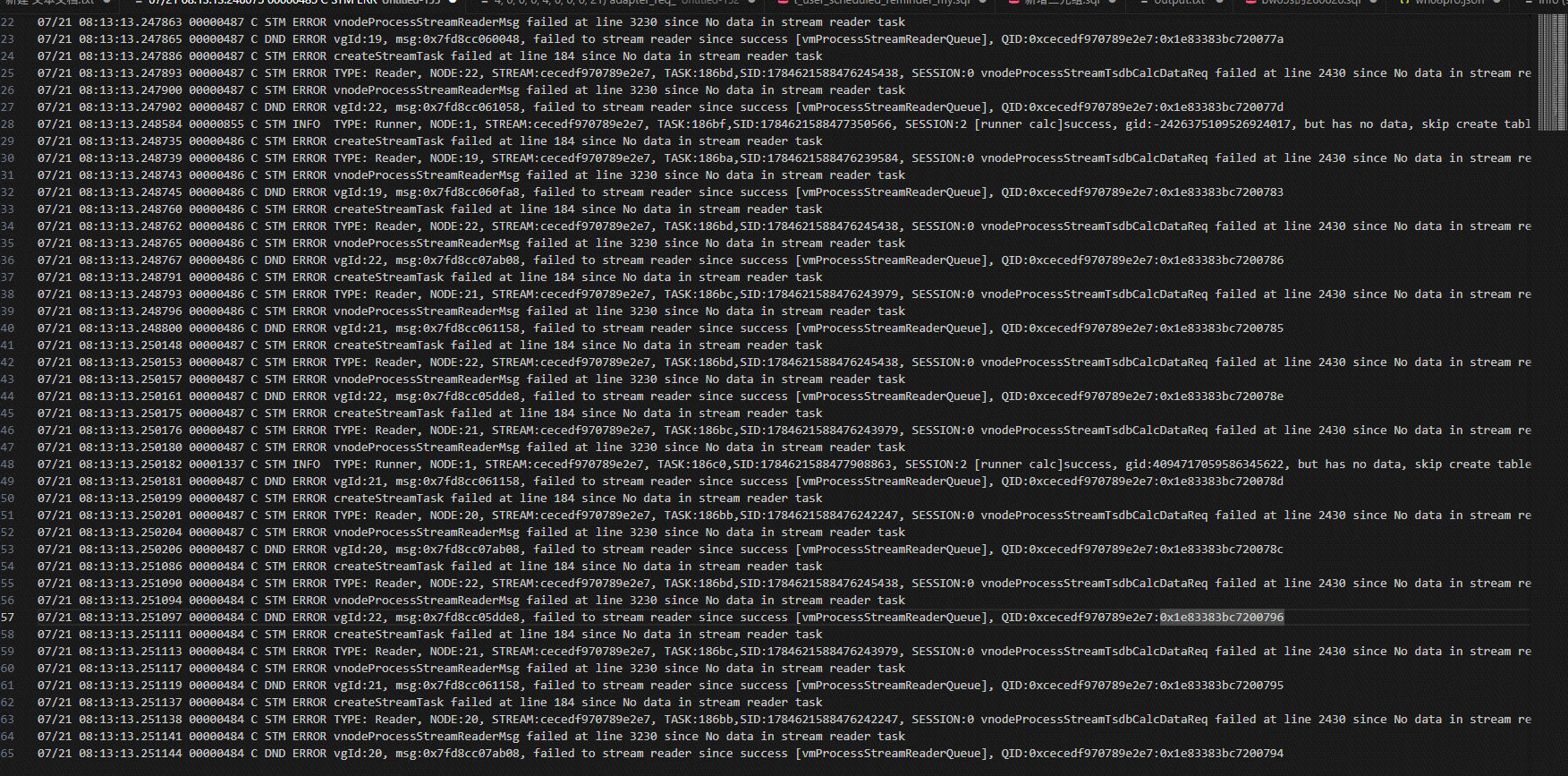

流错误导致tdengine挂掉,也无法重启
07/21 08:13:13.246075 00000485 C STM ERROR TYPE: Reader, NODE:21, STREAM:cecedf970789e2e7, TASK:186bc,SID:1784621588476243979, SESSION:0 vnodeProcessStreamTsdbCalcDataReq failed at line 2430 since No data in stream reader task
07/21 08:13:13.246080 00000485 C STM ERROR vnodeProcessStreamReaderMsg failed at line 3230 since No data in stream reader task
07/21 08:13:13.246082 00000485 C DND ERROR vgId:21, msg:0x7fd8cc060048, failed to stream reader since success [vmProcessStreamReaderQueue], QID:0xcecedf970789e2e7:0x1e83383bc720076d
07/21 08:13:13.246874 00000486 C STM ERROR createStreamTask failed at line 184 since No data in stream reader task
07/21 08:13:13.246882 00000486 C STM ERROR TYPE: Reader, NODE:21, STREAM:cecedf970789e2e7, TASK:186bc,SID:1784621588476243979, SESSION:0 vnodeProcessStreamTsdbCalcDataReq failed at line 2430 since No data in stream reader task
07/21 08:13:13.246889 00000486 C STM ERROR vnodeProcessStreamReaderMsg failed at line 3230 since No data in stream reader task
07/21 08:13:13.246892 00000486 C DND ERROR vgId:21, msg:0x7fd8cc07ab08, failed to stream reader since success [vmProcessStreamReaderQueue], QID:0xcecedf970789e2e7:0x1e83383bc7200776
07/21 08:13:13.246913 00000486 C STM ERROR createStreamTask failed at line 184 since No data in stream reader task
07/21 08:13:13.246916 00000486 C STM ERROR TYPE: Reader, NODE:20, STREAM:cecedf970789e2e7, TASK:186bb,SID:1784621588476242247, SESSION:0 vnodeProcessStreamTsdbCalcDataReq failed at line 2430 since No data in stream reader task
07/21 08:13:13.246921 00000486 C STM ERROR vnodeProcessStreamReaderMsg failed at line 3230 since No data in stream reader task
07/21 08:13:13.246926 00000486 C DND ERROR vgId:20, msg:0x7fd8cc060048, failed to stream reader since success [vmProcessStreamReaderQueue], QID:0xcecedf970789e2e7:0x1e83383bc7200775
07/21 08:13:13.246950 00000486 C STM ERROR createStreamTask failed at line 184 since No data in stream reader task
07/21 08:13:13.246955 00000486 C STM ERROR TYPE: Reader, NODE:19, STREAM:cecedf970789e2e7, TASK:186ba,SID:1784621588476239584, SESSION:0 vnodeProcessStreamTsdbCalcDataReq failed at line 2430 since No data in stream reader task
07/21 08:13:13.246960 00000486 C STM ERROR vnodeProcessStreamReaderMsg failed at line 3230 since No data in stream reader task
07/21 08:13:13.246963 00000486 C DND ERROR vgId:19, msg:0x7fd8cc05dde8, failed to stream reader since success [vmProcessStreamReaderQueue], QID:0xcecedf970789e2e7:0x1e83383bc7200774
07/21 08:13:13.247662 00000487 C STM ERROR createStreamTask failed at line 184 since No data in stream reader task
07/21 08:13:13.247668 00000487 C STM ERROR TYPE: Reader, NODE:21, STREAM:cecedf970789e2e7, TASK:186bc,SID:1784621588476243979, SESSION:0 vnodeProcessStreamTsdbCalcDataReq failed at line 2430 since No data in stream reader task
07/21 08:13:13.247677 00000487 C STM ERROR vnodeProcessStreamReaderMsg failed at line 3230 since No data in stream reader task
07/21 08:13:13.247681 00000487 C DND ERROR vgId:21, msg:0x7fd8cc0604c8, failed to stream reader since success [vmProcessStreamReaderQueue], QID:0xcecedf970789e2e7:0x1e83383bc720077c
07/21 08:13:13.247857 00000487 C STM ERROR createStreamTask failed at line 184 since No data in stream reader task
07/21 08:13:13.247859 00000487 C STM ERROR TYPE: Reader, NODE:19, STREAM:cecedf970789e2e7, TASK:186ba,SID:1784621588476239584, SESSION:0 vnodeProcessStreamTsdbCalcDataReq failed at line 2430 since No data in stream reader task
07/21 08:13:13.247863 00000487 C STM ERROR vnodeProcessStreamReaderMsg failed at line 3230 since No data in stream reader task
07/21 08:13:13.247865 00000487 C DND ERROR vgId:19, msg:0x7fd8cc060048, failed to stream reader since success [vmProcessStreamReaderQueue], QID:0xcecedf970789e2e7:0x1e83383bc720077a
07/21 08:13:13.247886 00000487 C STM ERROR createStreamTask failed at line 184 since No data in stream reader task
07/21 08:13:13.247893 00000487 C STM ERROR TYPE: Reader, NODE:22, STREAM:cecedf970789e2e7, TASK:186bd,SID:1784621588476245438, SESSION:0 vnodeProcessStreamTsdbCalcDataReq failed at line 2430 since No data in stream reader task
07/21 08:13:13.247900 00000487 C STM ERROR vnodeProcessStreamReaderMsg failed at line 3230 since No data in stream reader task
07/21 08:13:13.247902 00000487 C DND ERROR vgId:22, msg:0x7fd8cc061058, failed to stream reader since success [vmProcessStreamReaderQueue], QID:0xcecedf970789e2e7:0x1e83383bc720077d
07/21 08:13:13.248584 00000855 C STM INFO TYPE: Runner, NODE:1, STREAM:cecedf970789e2e7, TASK:186bf,SID:1784621588477350566, SESSION:2 [runner calc]success, gid:-2426375109526924017, but has no data, skip create table.
07/21 08:13:13.248735 00000486 C STM ERROR createStreamTask failed at line 184 since No data in stream reader task
07/21 08:13:13.248739 00000486 C STM ERROR TYPE: Reader, NODE:19, STREAM:cecedf970789e2e7, TASK:186ba,SID:1784621588476239584, SESSION:0 vnodeProcessStreamTsdbCalcDataReq failed at line 2430 since No data in stream reader task
07/21 08:13:13.248743 00000486 C STM ERROR vnodeProcessStreamReaderMsg failed at line 3230 since No data in stream reader task
07/21 08:13:13.248745 00000486 C DND ERROR vgId:19, msg:0x7fd8cc060fa8, failed to stream reader since success [vmProcessStreamReaderQueue], QID:0xcecedf970789e2e7:0x1e83383bc7200783
07/21 08:13:13.248760 00000486 C STM ERROR createStreamTask failed at line 184 since No data in stream reader task
07/21 08:13:13.248762 00000486 C STM ERROR TYPE: Reader, NODE:22, STREAM:cecedf970789e2e7, TASK:186bd,SID:1784621588476245438, SESSION:0 vnodeProcessStreamTsdbCalcDataReq failed at line 2430 since No data in stream reader task
07/21 08:13:13.248765 00000486 C STM ERROR vnodeProcessStreamReaderMsg failed at line 3230 since No data in stream reader task
07/21 08:13:13.248767 00000486 C DND ERROR vgId:22, msg:0x7fd8cc07ab08, failed to stream reader since success [vmProcessStreamReaderQueue], QID:0xcecedf970789e2e7:0x1e83383bc7200786
07/21 08:13:13.248791 00000486 C STM ERROR createStreamTask failed at line 184 since No data in stream reader task
07/21 08:13:13.248793 00000486 C STM ERROR TYPE: Reader, NODE:21, STREAM:cecedf970789e2e7, TASK:186bc,SID:1784621588476243979, SESSION:0 vnodeProcessStreamTsdbCalcDataReq failed at line 2430 since No data in stream reader task
07/21 08:13:13.248796 00000486 C STM ERROR vnodeProcessStreamReaderMsg failed at line 3230 since No data in stream reader task
07/21 08:13:13.248800 00000486 C DND ERROR vgId:21, msg:0x7fd8cc061158, failed to stream reader since success [vmProcessStreamReaderQueue], QID:0xcecedf970789e2e7:0x1e83383bc7200785
07/21 08:13:13.250148 00000487 C STM ERROR createStreamTask failed at line 184 since No data in stream reader task
07/21 08:13:13.250153 00000487 C STM ERROR TYPE: Reader, NODE:22, STREAM:cecedf970789e2e7, TASK:186bd,SID:1784621588476245438, SESSION:0 vnodeProcessStreamTsdbCalcDataReq failed at line 2430 since No data in stream reader task
07/21 08:13:13.250157 00000487 C STM ERROR vnodeProcessStreamReaderMsg failed at line 3230 since No data in stream reader task
07/21 08:13:13.250161 00000487 C DND ERROR vgId:22, msg:0x7fd8cc05dde8, failed to stream reader since success [vmProcessStreamReaderQueue], QID:0xcecedf970789e2e7:0x1e83383bc720078e
07/21 08:13:13.250175 00000487 C STM ERROR createStreamTask failed at line 184 since No data in stream reader task
07/21 08:13:13.250176 00000487 C STM ERROR TYPE: Reader, NODE:21, STREAM:cecedf970789e2e7, TASK:186bc,SID:1784621588476243979, SESSION:0 vnodeProcessStreamTsdbCalcDataReq failed at line 2430 since No data in stream reader task
07/21 08:13:13.250180 00000487 C STM ERROR vnodeProcessStreamReaderMsg failed at line 3230 since No data in stream reader task
07/21 08:13:13.250182 00001337 C STM INFO TYPE: Runner, NODE:1, STREAM:cecedf970789e2e7, TASK:186c0,SID:1784621588477908863, SESSION:2 [runner calc]success, gid:4094717059586345622, but has no data, skip create table.
07/21 08:13:13.250181 00000487 C DND ERROR vgId:21, msg:0x7fd8cc061158, failed to stream reader since success [vmProcessStreamReaderQueue], QID:0xcecedf970789e2e7:0x1e83383bc720078d
07/21 08:13:13.250199 00000487 C STM ERROR createStreamTask failed at line 184 since No data in stream reader task
07/21 08:13:13.250201 00000487 C STM ERROR TYPE: Reader, NODE:20, STREAM:cecedf970789e2e7, TASK:186bb,SID:1784621588476242247, SESSION:0 vnodeProcessStreamTsdbCalcDataReq failed at line 2430 since No data in stream reader task
07/21 08:13:13.250204 00000487 C STM ERROR vnodeProcessStreamReaderMsg failed at line 3230 since No data in stream reader task
07/21 08:13:13.250206 00000487 C DND ERROR vgId:20, msg:0x7fd8cc07ab08, failed to stream reader since success [vmProcessStreamReaderQueue], QID:0xcecedf970789e2e7:0x1e83383bc720078c
07/21 08:13:13.251086 00000484 C STM ERROR createStreamTask failed at line 184 since No data in stream reader task
07/21 08:13:13.251090 00000484 C STM ERROR TYPE: Reader, NODE:22, STREAM:cecedf970789e2e7, TASK:186bd,SID:1784621588476245438, SESSION:0 vnodeProcessStreamTsdbCalcDataReq failed at line 2430 since No data in stream reader task
07/21 08:13:13.251094 00000484 C STM ERROR vnodeProcessStreamReaderMsg failed at line 3230 since No data in stream reader task
07/21 08:13:13.251097 00000484 C DND ERROR vgId:22, msg:0x7fd8cc05dde8, failed to stream reader since success [vmProcessStreamReaderQueue], QID:0xcecedf970789e2e7:0x1e83383bc7200796
07/21 08:13:13.251111 00000484 C STM ERROR createStreamTask failed at line 184 since No data in stream reader task
07/21 08:13:13.251113 00000484 C STM ERROR TYPE: Reader, NODE:21, STREAM:cecedf970789e2e7, TASK:186bc,SID:1784621588476243979, SESSION:0 vnodeProcessStreamTsdbCalcDataReq failed at line 2430 since No data in stream reader task
07/21 08:13:13.251117 00000484 C STM ERROR vnodeProcessStreamReaderMsg failed at line 3230 since No data in stream reader task
07/21 08:13:13.251119 00000484 C DND ERROR vgId:21, msg:0x7fd8cc061158, failed to stream reader since success [vmProcessStreamReaderQueue], QID:0xcecedf970789e2e7:0x1e83383bc7200795
07/21 08:13:13.251137 00000484 C STM ERROR createStreamTask failed at line 184 since No data in stream reader task
07/21 08:13:13.251138 00000484 C STM ERROR TYPE: Reader, NODE:20, STREAM:cecedf970789e2e7, TASK:186bb,SID:1784621588476242247, SESSION:0 vnodeProcessStreamTsdbCalcDataReq failed at line 2430 since No data in stream reader task
07/21 08:13:13.251141 00000484 C STM ERROR vnodeProcessStreamReaderMsg failed at line 3230 since No data in stream reader task
07/21 08:13:13.251144 00000484 C DND ERROR vgId:20, msg:0x7fd8cc07ab08, failed to stream reader since success [vmProcessStreamReaderQueue], QID:0xcecedf970789e2e7:0x1e83383bc7200794

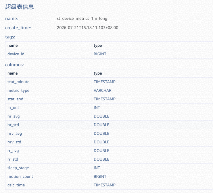

流sql:create stream if not exists lute_aiot_human_metrics.s_sleep_stage_calibrate_1m interval(1m) sliding (1m)
from
lute_aiot_human_metrics.st_device_metrics_1m_long
partition by
device_id stream_options (
fill_history (1) | event_type (window_close) | watermark (10m)
) into lute_aiot_human_metrics.st_sleep_stage_calibrated output_subtable (
concat(
‘t_sleep_stage_calibrated_’,
cast(device_id as varchar)
) (ts, raw_stage, calibrated_stage, calc_time) as
select
case
when max(
case
when metric_type = ‘bed’ then in_out
else null
end
) = 1
and max(
case
when metric_type = ‘stage’ then sleep_stage
else null
end
) is not null then _twstart
else cast(null as timestamp)
end as ts,
max(
case
else null
end
) as raw_stage,
cast(
case
when max(
case
else null
end
) = 1 then 1
when coalesce(
max(
case
when metric_type = ‘motion’ then motion_count
else null
end
0
) > 3 then 2
when coalesce(
max(
case
when metric_type = ‘hr’ then hr_std
else null
end
0
) > 5.0
or coalesce(
max(
case
when metric_type = ‘rr’ then rr_std
else null
end
0
) > 2.5 then 2
else 3
end as int
) as calibrated_stage,
now() as calc_time
from
where
device_id = % % 1
and stat_minute >= _twstart
and stat_minute < _twend;
